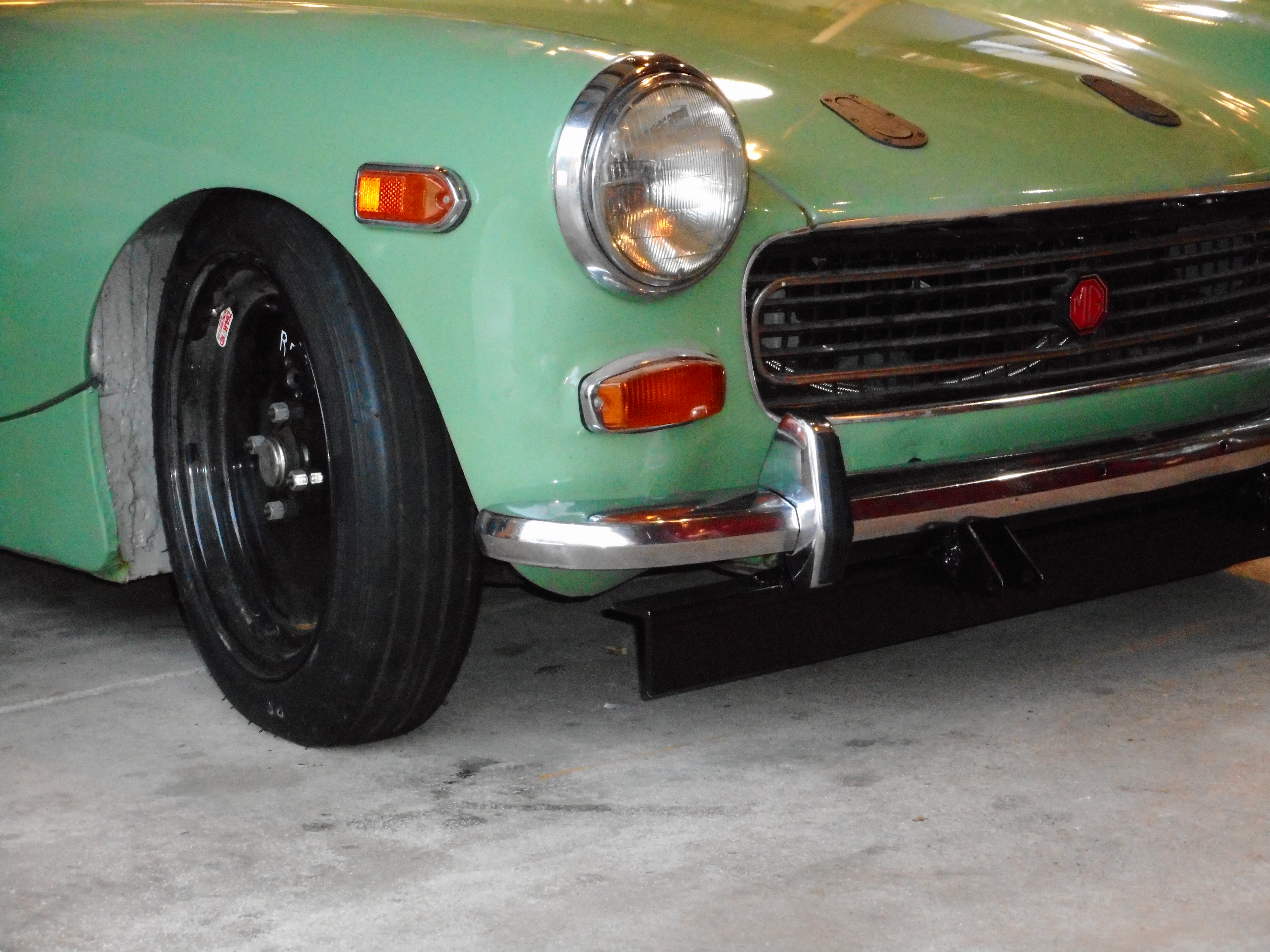

As I mentioned yesterday, the MGT class lets me use a non-factory air dam. A good thing, too, because MG never thought to offer a chin spoiler.
Part of the "charm" of this build is that I've been able to maintain a fairly stock appearance of the car. As a brand loyalist, it's important to me personally. But I also recognize I'll need to make some modifications in order to be competitive.
I was able to build a new front bumper mount that removes the old "buggy spring" attachment and replaces it with t 1 1/2 x 3 piece of rectangular tubing. Below that, I'll be attaching a 2 x 3 piece of angle iron, and to that I'll be attaching a pair of mounts for the tow bar and covering it with a piece of ABS plastic to extend it down to just 3" off the ground.
DSCN0121[1] by Chris Conrad, on Flickr

DSCN0122 by Chris Conrad, on Flickr
And while my welding skills are always a bit sub par, I'm giving myself an "attaboy" on this one. Combination bumper bracket, air dam and tow bar attachments. And given that the K weighs less than the A, a few extra pounds hanging over the front end at 130 mph is probably a good thing.
Heck, I can throw snow tires on it this winter and plow the alley!
DSCN0123 by Chris Conrad, on Flickr

I was going to extend the edge of the air dam a little further down, but I still need some suspension compliance, so this is the compromise I settled on -
DSCN0124 by Chris Conrad, on Flickr
I'll figure out some sort of fill outside the bumperettes, but straight on, the lower edge of the dam is 3" below the lowest edge of the fender and still provides me enough clearance to prevent us from accidentally grooming the track.

How 'bout losing the bumper guards?  Is it legal?  Sure look cleaner without them.

Looks like the rules for MGT are similar to Altered. Bumpers can be removed and lights covered BUT radiator may NOT be blocked. Lose the bumper entirely and cover from the radiator opening down with air dam?

The bumperettes have a captured nut that hold the rest of the bumper in place, but I suppose I could get a couple of chrome bolts and draw it up on the back side? I'll give it some thought.
